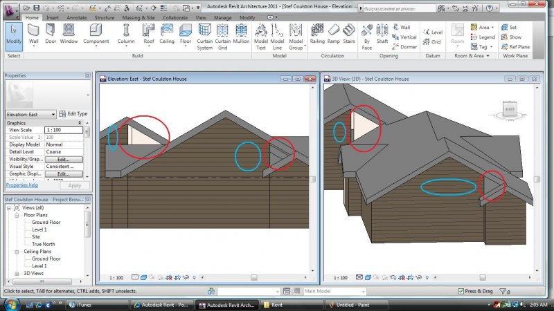

not sure how to explain this correctly, so hopefully the image attached helps.
okay, basically what i want to do is fill the red circle area with the same material as the blue circle (or a different material, unsure at this stage). There was one way where i just extend the walls across, but in doing so, it greatly affects the floor plan.
so is there a way to put a surface material in this area? you see this in a lot of houses, and i want to find a way to do this in revit. i dont even know what to search, so sorry if there has already been a thread on this.
hope somebody knows.
if you dont understand my mumbo jumbo, say and ill see if i can explain it further
I think that you can:
Select the wall, (preferably in an elevation view)
Select "Edit Profile"
While you're in editing mode, use the tools or erase lines... click & drag the ends of line to move them accordingly
(You won't be able to close out of the editor if there any gaps)
When you're finished, click the green check-mark to accept the changes and return to the last view you were in.
