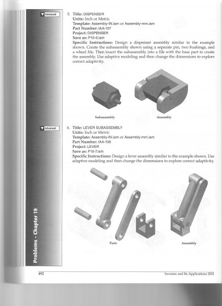

I am having some difficulty creating this particular part in the attached image. It is under number 6 and is the piece that has two cylinders at each end with a rod in between them. I am not sure how to create this within a single part file. Could someone give me some assistance on this?
I have created the bottom cylinder and extruded it fine. I then tried to paste using 'paste features' dialog box to insert another copy of it and then do an extrusion 'between' the two cylindrical side faces, but i can't get it to paste correctly. It wants to sit up on its end on the top of the middle rod extrusion.. I will post up the pt file i have so far on this one part as well.

Well, from the point your at now, you can simply "Move Face" half your rod length and then mirror the solid as such:
KC
Thanks a lot for that video. I got it to work.
