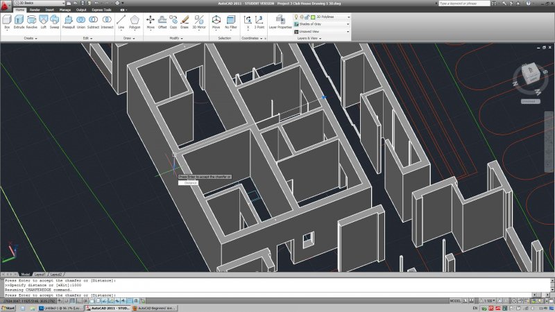

Hi,
I'm having trouble creating a pitched roof on this model.
The central block you see in the picture needs to go from 4m high on the right down to 3m high on the left. I've tried using the chamfer tool, selecting the left side top edge, dragging down 1 m, then dragging the horizontal arrow across to the other end, but when I hit enter it doesnt do anything :/
Its a single solid, all the boxes etc. have been combined with union.
Is there a better way of doing this?
I don't think CHAMFEREDGE works on faces with multiple parallel edges. Perhaps figure out the angle of the pitch and use SOLIDEDIT > TAPER
or SLICE with the 3point option to define a cutting plane
Oh ok I thought that might be the case.
Please can you explain in more detail how to use slice with the 3point option? I havent used that before.
Thanks.

I've had a quick play with the slice tool but rather baffled by what its asking me, perhaps you could show me which specific points to pick relating to my screenshot?
The SLICE command will work if you use the Surface option. A line representing the pitch of the roof is drawn then extruded (thus resulting in a surface). The user is prompted to pick the object to be sliced and the surface to be used. He/she is given the option of saving one or both sides of the resultant geometry. I usually use the default of Both then go in and erase what I don't want. Need an example?
Worked like a charm, Thanks for your help. :)

Good, I see you figured it out using a surface as your cutting plane as Remark suggested. 3Point works basically the same way, except you just pick 3 points to define the plane instead of actually creating a surface beforehand.
