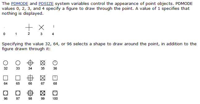

GVR Posted December 21, 2010 Posted December 21, 2010 Hello, I have used the point-command for the first time and i must say that it is a nice option. But i have a little problem with it. If i print the drawing i see al the points on my print. So is there a option that al the points are not printed? Or do i have to put al the points on a separate layer that i don't print. Thanks already. And a Merry Christmas to everybody. Quote
ReMark Posted December 21, 2010 Posted December 21, 2010 I just love these self answering questions. Makes life so much easier. Quote
alanjt Posted December 21, 2010 Posted December 21, 2010 Look at PDMODE and PDSIZE. Straight from Help: Quote
JPlanera Posted December 21, 2010 Posted December 21, 2010 put al the points on a separate layer that i don't print. heyoooo!!!!! Quote
GVR Posted December 21, 2010 Author Posted December 21, 2010 Thanks for the fast answers. I know i give myself a answer but a solution that someone uses is not always the best/fastest solution. So i asked it anyway to see if ther is a better solution. And indeed a can us the point variable 1, but then i don't see the point in the drawing. And when i use e separate layer i have one layer more in my drawing and i want to keep the drawing so cleen as posible. That's way i asked it. Quote

eldon Posted December 22, 2010 Posted December 22, 2010 I would favour a non printing layer for the points, because then you can see them. Otherwise you have got to set PDMODE all the time. Quote

fahim108 Posted January 8, 2011 Posted January 8, 2011 Sorry to bump this post, but I had to ask... Has anyone observed what happens when you put a Point in the Defpoints Layer? It magically converts into a tiny dot irrespective of what PDMODE value you set... Quote
eldon Posted January 8, 2011 Posted January 8, 2011 Sorry to bump this post, but I had to ask... Has anyone observed what happens when you put a Point in the Defpoints Layer? It magically converts into a tiny dot irrespective of what PDMODE value you set... Probably not a lot of people know that. It seems to be a function of Defpoints layer, that all points in that layer are mode 0, because all dimensions have a point at each end of the dimension, and having a point at any other mode would make the drawing look very untidy Quote
