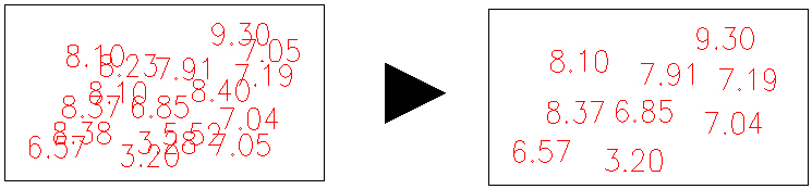

I have many texts overlapping. I want to delete texts which are overlapping...Sorry, i'm very poor English.
I have an Ex in picture
Please help me! Thanks!!!
What condition determines which text entity to delete if overlapping?
I only need after delete some of texts, no text is overlapping. If textbox is overlapping, delete it.

If you think about it, it isn't just for this example though - it would apply to every overlap. And what if three text items are all overlapping each other? Now what do we delete? And for 'n' overlaps?
unusual to not care what gets deleted...... a smaller text size is obviously out of the question?!!

Just a guess, but the numbers look like topographic data. Perhaps the user just wants some pieces of data deleted because they're redundant, and whatever's left over, regardless of what process performed the deleting, will have an even enough spread to be accurate as per the user's needs?
If it was me, I'd just lower the font size to the point where they didn't overlap and tell everyone else to pull out a magnifying glass if they can't read it.
EDIT: I suppose OVERKILL wouldn't work, because the text strings are different? I know you could set the fuzz to some really high number, but I don't know if you can tell it to work with just entity type and position, and disregard text strings.. hm..

I am also interested in this lisp to delete overlapping text as describe by tieptouch. To understand the overlap text - basically there are a bunch of points picked up on the ground by the surveyors. Then it is transfer to the survey software which generate all the text to a specific height (e.g 1.6m on autocad). Especially for roads, there are drain, cutting on either sides. Thus there will be a lots of points being picked up as edge of road, guardrail, right side of drain, drain invert, left side of drain, bottom of cutting, top of cutting etc. The text (that will be the code, point number and the point elevation) - but we are looking at will be the text elevation. Since all the text elevation will be display and this causes the overlapping. Since we need to randomly delete the text elevation so that in the end it looks nice as shown by tieptouch. So which point to delete do not matter.
Hope this explain clearly. Thanks.

You may be use sth like that :
(defun c:FText (/ ent ent1 i lst newlayer ofset ss ss1 ss_tmp ans)

It will fil text that overlap follow distance you choice (offset from textbox), and change all found Text to layer Text_Filter, and let you decide erase or not. Text to keep is belong to sort of create
Thanks a lot Ketxu. That is what I need. Thank you again.
