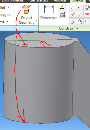

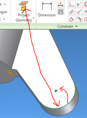

I haven't watched those videos - but I assume you need to be in an active sketch and click the Project Geometry tool and then the edge you want to project into the current sketch. Do this - pause the video exactly where you get stuck and then hit Alt + Print Screen key (prt sc) upper right corner of keyboard.
Open MS Paint and Ctrl V to paste the image into Paint.
Save and attach the screen capture here.
Thank you very much, JD Mather! :D I think this is exactly what I was looking for, and your pictures show exactly what I was struggling with. There must be both an active sketch AND I need to use the project geometry tool. This is starting to work for me now.
Yes, now if you go back and make changes (like size) in the original geometry it will automatically be updated in the sketch that it was projected into. This is the power of parametric modeling.
