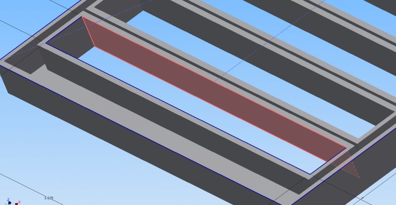

When I make a shell .05 inch thick, if i want to cut the material so the red highlighted slice of material can bend to make a louver can I split it apart to pivot it on the axis or should I convert to sheet metal first?
What I actually need to do is only make a shell with the outer most boundary -with there being no shells in the center around the holes - and have the louvers the size of the holes and bent.
I just noticed I need to bend the plane across the red highlighted section in the picture so as to direct air flow in the vent outwards but it should still be the same principle for learning purpose.
