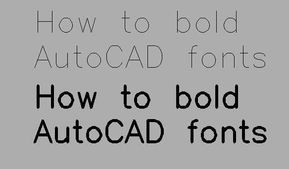

6) AutoCAD shx fonts can't be bolded. Perhaps try one of the TrueType fonts such as Arial, Courier, or TimesNewRoman.
Edited by nestly
You can sort of, by assigning a line weight
