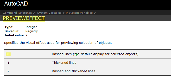

kencaz Posted January 1, 2011 Posted January 1, 2011 I would suggest keeping your "selectionpreview" at '3' What really slows down systems with on board graphics is the Thickened lines when the cursor is passed over. The default for new autocad installations is "both" Thicken and Dashed. This can really tax even a good system if there are a lot of objects. I would suggest as I do change the "PREVIEWEFFECT" variable to '0' KC Quote

Marc5 Posted January 3, 2011 Author Posted January 3, 2011 Once agian, thanks to all. Exspress Tools loaded and SELECTIONPREVIEW is set to (3) and will remain at (3) at the momnent. I did changed PREVIEWEFFECT to (0) it was at (2). If pointer sticks, I will change SELECTIONPREVIEW to (0) as suggested. I will post in a few days if these changes (along with others mentioned above) helped pointer "sticking". Thanks....... Quote
Marc5 Posted January 19, 2011 Author Posted January 19, 2011 Update........There has been no "sticking" of the mouse since the changes made suggested above. Thanks, again. Quote
