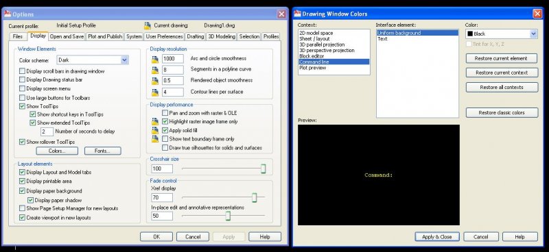

not a variable but under Options > Display tab > Colors > Commandline.

In 2010, its in the "tools" menu, then all the way to the bottom for "options", then the display tab, and hit the "colors" button about midway down in that dialog box. See below.
Tiger, I made my command line background black, then changed the text color to yellow. I draw on a black background too. Easier on my eyes than the standard white background.
