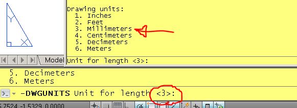

After running MASSPROP it gives me numbers for mass and volume... But no units... What are those units? I cant seem to find anything that tells me
Thanks
V
Example :
Lists the mass and volume of a fitting cap at 125
Is that cubic inches, cubic centimeters, cubic milliliters, etc...
Or am I just not thinking about this correctly?
Depends on your template units.
Assuming you started from correct template (inch or metric) you should be able to figure out the units based on a quick hand calculation of the expected bounding box.

Use -dwgunits (include the hyphen) at the commandline, then hit F2 to open your text window.
The numeric response you get at the commandline like which means mms,
will identify the database drawing unit, upon which all distance, area and volumetric
measurement feedback will be based.
