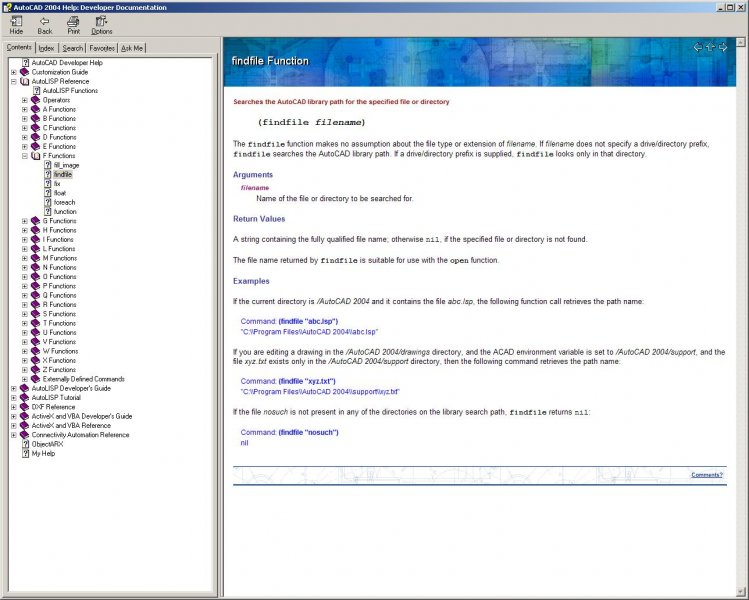

Anyway the attached program has three external blocks assuming they are in a directory called C:/Symbols. This directory would need to be in the Support path and or can be changed to what you want to name it to. The three blocks are in the program list. You can change these to what you wish as well along with the block scale list which is setup for Imperial units. You may want to change this to metric.
I commented the program as much as possible to give you an idea as to whats is going on. I also removed the images incase you decide to use this program with your blocks. To make images for your blocks could be a whole thread by itself, So I did not want to get into it at this point.
The program name is BLKLIB2.lsp with BLKLIB2.dcl
Command syntax: BLKLIB2
Place the blocks in a directory called Symbols or choose what you like as long as you edit it in the program.

I just look findfile up and its restricted to the Support Search Path as shown in the image.

You did not edit this conditional for one thing.
What are the layer names?
What is the object layer name?
Are there attributes?
Are the attributes on a different layer?
     (cond
       ((= BNAM "TRIANGLE")(setq ALAY "TRIANGLE TEXT")(setq OLAY BNAM AVAL BNAM))
       ((= BNAM "SQUARE")  (setq ALAY "SQUARE TEXT")  (setq OLAY BNAM AVAL BNAM))
       ((= BNAM "CIRCLE")  (setq ALAY "CIRCLE TEXT")  (setq OLAY BNAM AVAL BNAM)))
The slashes are not correct.
(findfile (strcat "C:\Documents and Settings\ldibiase\Desktop\Symbol Library" BNAM ".dwg"))
You can do it one of two ways like this.
(findfile (strcat "C:\\Documents and Settings\\ldibiase\\Desktop\\Symbol Library" BNAM ".dwg"))
(findfile (strcat "C:/Documents and Settings/ldibiase/Desktop/Symbol Library" BNAM ".dwg"))
