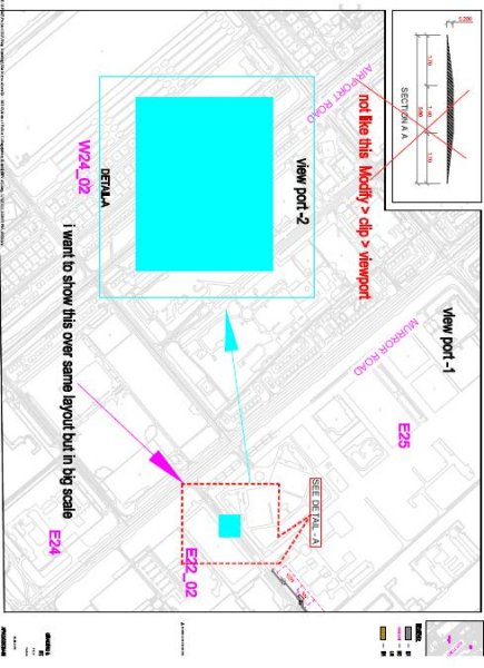

Hy guys i want to set one view port on another view port how can i set this pls help me in layout i want to show one view port on another supoose i want to show one detail in big scale to another vieport but in same layout tab

this is drawing i wnt to show this part in over layout in big scale how pls use sample english then i ll understand easly how can i put mask tel me commond
Try draw a pline outline of outside but with a sq inside like a old fashioned key then use MV P polygon to trace over but this leaves a keyhole of no plot area which you make a 2nd plot window to make sq
please send me screen shoot and try to use easy english im not english man im Pakistani i ca'nt understand ur english use sample word for understanding me

plse can u send me screen display how im trying but i coud'nt put viewport on WIPEOUT pls help me how can i show it
