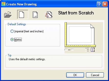

Another alternative to creating a new drawing is to Start from Scratch.
If you use a .dwg file as your template file, you will have to always remember to do a "Save As" on your first save. If you accidentally hit "Save" instead of "Save As", you will save all of your changes to your .dwg template. It's too easy to make that mistake. That's why we have .dwt template files. If you select acad.dwt to start your drawing, then you make changes and hit "Save, you will be prompted for a .dwg file name and asked where to save the file. You cannot accidentally overwrite a .dwt template file.
