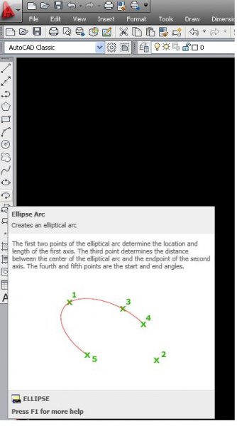

You're welcome. Another thing you can do is to go to the "tools" menu and bring up the options dialog box. Find the "tool tips" boxes and turn them on if they aren't already. As a new user, you may find these helpful. With them turned on, pausing over the various buttons will pop up the name of the command and a brief explanation of what it does. A longer pause will give an extended description, and either will give you a chance to get even more help without actually starting the command by hitting the F1 button. See the examples below.
After you gain more knowledge and experience you'll probably want to turn them back off as they can be annoying if you don't need them.
