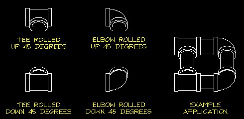

I am drawing blocks of threaded and socket weld pipe fittings in all normally used views and because the O.D. of the ends of the fittings varies with material and pressure class, for rotated views I create ellipses using the center ellipse command, then enter "R" for rotation then enter the rotation angle.
Does anyone have a lisp that will allow me to pick the diameter (or center and long axis) with 2 points and have the routine to initiate the rotation at 45 and finish the ellipse.

what do you mean by that?
pBe,
The image shows 3"-300# Malleable Iron 90 Degree Elbow and 3"-300# Malleable Iron Straight Tee in both the rolled up and rolled down positions.
This?
(defun c:e45 ( / p1 p2 )
 (if
   (and
     (setq p1 (getpoint "\nAxis Endpoint: "))
     (setq p2 (getpoint "\nOther Endpoint: " p1))
   (command "_.ellipse" "_non" p1 "_non" p2 "_R" 45.0)

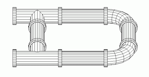

Have you thought about 3D modeling? That would make life a lot easier with that type of work. -David
Or, as an improvement on the previous code:
(defun c:e45 ( / *error* p1 p2 cmd )
 (defun *error* ( msg )
   (if cmd (setvar 'CMDECHO cmd))
   (or (wcmatch (strcase msg) "*BREAK,*CANCEL*,*EXIT*")
       (princ (strcat "\n** Error: " msg " **")))
 (setq cmd (getvar 'CMDECHO))
 (setvar 'CMDECHO 0)
 (if
     (initget "Center")
     (setq p1 (getpoint "\nSpecify Axis Endpoint [Center]: "))
   (cond
       (eq "Center" p1)
       (if
         (and
           (setq p1 (getpoint "\nSpecify Center of Ellipse: "))
           (setq p2 (getpoint "\nSpecify Endpoint of Axis: " p1))
         (command "_.ellipse" "_C" "_non" p1 "_non" p2 "_R" 45.0)
     ( (setq p2 (getpoint "\nSpecify Other Endpoint of Axis: " p1))

I'd still recommend a 3D route if you are doing a lot of this kind of stuff.
David,
That stuff is way over my head. I can barely draw lines and circles in 2D.
That for the suggestion though.

Lee Mac,
I've been offline playing with this new toy (tool).
Works perfectly. I really appreciate you taking your valuable time to write this for me.
