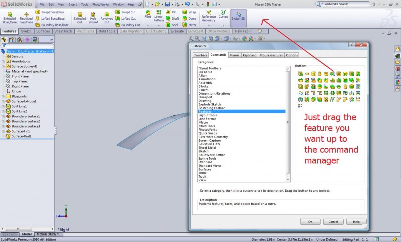

I seemed to have deleted some of the icons from my Features tool bar, how do I restore them back to default. I was trying to get the tool bar back to the top of the page and a red X was appearing while I was dragging and thought it was going to bring the whole tool bar......only to discover I had deleted sever icons like extrude and revolve etc......:oops::oops::oops::oops:
are you talking about the ribbon or actual tool bars? Another name for the ribbon is the Command Manager. If you right click up top next to your file name and the save/rebuild buttons you can turn the command manager on and off. I dont think you can remove buttons from actual tool bars so I imagine this is what you are talking about. If you right click up there and go to customize you can view all the 'buttons' you can add by going to the commands tab on the Customize window. Simply drag which ones you want up to the top.
Oh yeah. 2010 add the right click-drag menu as well. In a model or sketch you can hold down the right mouse button and drag up and to the right. This will open up either 4 or 8 commands(based on your settings). You can also use the quick menu by pressing the S key. This will allow you to add commands as well. The quick menu and click-drag menus are different in a sketch, part and assembly file. As far as I know there isnt a limit to the "S" quick menu but i only keep a few things on there that i use a lot like dimensions.
