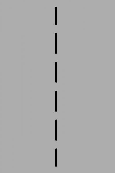

paulie Posted January 12, 2011 Posted January 12, 2011 Hello! I am using difenent layers for my drawing, an i want to have on one a lineweight of 0.7mm. The problem is whem i set the lineweight as 0.7 mm from the layers menu i think i get a too thick line as you can see in the picture below. I did not plot the drawing yet, but in the picture there is a line of 41mm and a lineweight of 0.7mm. I think the line is way more thicker than 0.7. Can someone plese tell me what am i doing wrong? Thank you! Quote
ReMark Posted January 12, 2011 Posted January 12, 2011 Are you sure that the lineweight is 7mm and not .7 or almost 3/4" thick? You know you can do a "test plot" of a small section of a drawing to confirm the lineweights are what you want. I'm assuming the line that of 41mm is the one to the left correct? Quote
eldon Posted January 12, 2011 Posted January 12, 2011 you are not doing anything wrong. The Line-weight displayed on the screen seems to be a function of pixels, so does not accurately show the as-plotted width of the line. Only a plot will show it. These two pictures show the same line and lineweight, but at differing zooms. Quote
ReMark Posted January 12, 2011 Posted January 12, 2011 Disable "sausage" mode (LWT) and you'll be fine. Judge the drawing by how it plots. Quote
Dana W Posted January 12, 2011 Posted January 12, 2011 In my 2009 LT I go to Tools > Options > User Preferences > and click the Lineweight settings button at the lower left of the preferences dialog box. There is a sliding scale button to adjust the screen display thickness of lines. I have mine set at about 20%. This is merely a visual differentiation ratio on the screen. The lineweights you see on your screen have little to do with how they plot. A 0.7mm line will plot at exactly that, but it will display according to how your user preferences are set up. This feature is there so those of us who work mostly zoomed way into details can see the lineweight differences easily. If you have your sliding scale set to show really fat on the screen, it will look horrible when zoomed out. Quote

SLW210 Posted January 12, 2011 Posted January 12, 2011 I turned LWT off the first time I loaded up the software and haven't used it since. Exactly! If I need different lineweights in a drawing I set that up in the plotter. In ACAD 2011 you can adjust fading by layer as well. Quote
