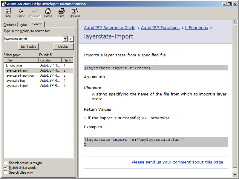

alanjt Posted January 13, 2011 Posted January 13, 2011 It's a function, not a command. Call as: (layerstate-import <FileNamehere>) Quote
jtk07 Posted January 13, 2011 Author Posted January 13, 2011 Yes i understand that, now the question is how can i apply it to a lisp or a objectDBX? what would the code be? Remeber I am trying to restore a layerstate from an imported las file I dont get that help screen any longer when you go to autocad 2011 you use online help thats more like online loop without answers. It's a function, not a command.Call as: (layerstate-import <FileNamehere>) [ATTACH]25755[/ATTACH] Quote
irneb Posted January 14, 2011 Posted January 14, 2011 Say your LAS file is c:\Test.LAS and the state inside it is called StateTest. You import it to the current drawing thus: (if (layerstate-import "C:\\Test.LAS") (princ "Test.LAS has been imported.") (princ "There was an error importing Test.LAS") ) Now to set the StateTest for the model space: (if (layerstate-restore "StateTest" nil) (princ "StateTest has been restored.") (princ "There's an error restoring StateTest") ) If you want to restore the state to a viewport only, you need to first obtain the VP's ename. E.g. if you want to restore the state to all VPs in the current DWG and use VP-overrides instead of setting colours & linetypes for the layers in total: (setq ss (ssget "_X" '((0 . "VIEWPORT"))) n (sslength ss)) (while (>= (setq n (1- n)) 0) (layerstate-restore "StateTest" (ssname ss n) 4) ) Quote
