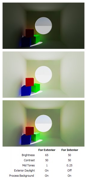

For those who prefer to work just under the sun, here are some render-exposure settings that may prove helpful while rendering interior/exterior views. :geek:
The following is a sun-lit scene with absolutely no extra light sources.
You shall need to maximize the render quality in-order to see the effect. To do that use the following render settings:
LIGHTINGUNITS > 2
SUNPROPERTIES Status > On, Sky status > Background and Illumination.
GEO (Geographic Location) > as per your location.
RPREF (Render Preset) > Presentation.
Global Illumination > On, Photons per sample > 25, Use Radius > On, Radius > 4500
Final Gather > On
Then, goto RENDEREXPOSURE and use the settings as listed in the image.
P.S. The third image is post-processed. It is an HDRI multiplication of the first two, done outside AutoCAD.
