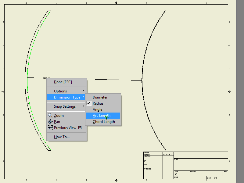

I´m working on a school project in which I've used a square pipe from content center and given it a radius with bend part.
The problem arises when i try to make the idw drawing. Inventor wont give me the "flat pattern". I know i can calculate the true unfolded length of the pipe but it would be so much easier if inventor could straighten it in inventor.
Another alternative would be a way to dimension an arc length.

I would not bother trying to flatten that unless you had holes or slots to cut. It's just a matter of the arc length...
Select the line in your idw, right click select dim type "arc length"
KC
Thanks for the help but as you see there are holes in the pipe.
