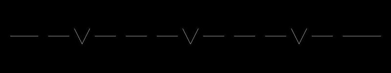

I'm trying to add linetypes using the acad.lin file and making adjustments.
All is fine, but I can't figure out how to create a linetype that has the appearance of a HIDDEN line, with the letter 'V' repeated every so often.
eg. __ __ __ v __ __ __ v __ __ __ v __ __ __
Any help or suggestions would be appreciated.
thanks in advance
put this ion your acad.lin file. experiment with settings as required
*Hidded_V, custom hidden line ---v---v---v---
A,.2,-.2,.2,-.2,.2,-.2,["V",STANDARD,S=.2,U=0.0,X=-.1,Y=0.0],-.2

This linetype definition below may be what you are looking for. It was made with MKLTYPE command from Express Tools. This is a very easy way to make linetypes.
V.lin
*V,V Line
A,.0625,-.0625,.125,-.03125,["V",Standard,y=-.046875,s=.09375],-.125,.125,-.0625,.0625
