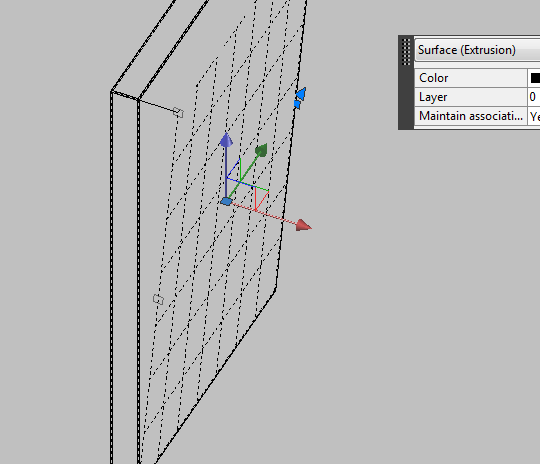

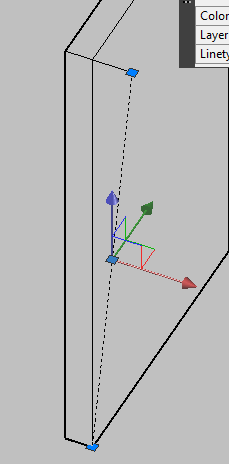

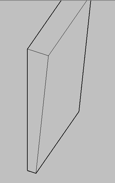

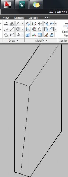

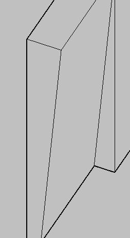

Raudel Solis Posted February 1, 2011 Posted February 1, 2011 i could help when it comes to autocad but revit, no, on autocad custom tapering could be done with a spline, extrude, and press pull command thats just 1 way of doing it, Revit Blend command might work also you might find this interesting http://revitclinic.typepad.com/my_weblog/2009/08/10-wall-tips.html Quote
