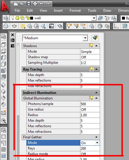

Raudel Solis Posted February 1, 2011 Posted February 1, 2011 when dealing with lights and sun final gather should always be used if sun is active global illumination should be active as well and yes, also post a screenshot Quote

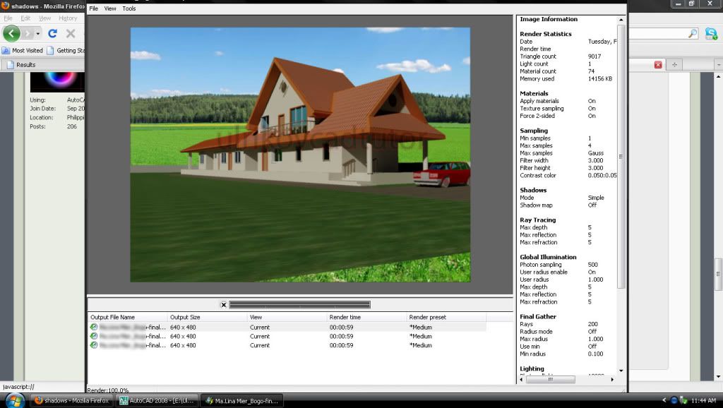

ulrikov Posted February 6, 2011 Posted February 6, 2011 Yes, I have this problem also... This is the screenshot. Quote

ulrikov Posted February 7, 2011 Posted February 7, 2011 when dealing with lights and sunfinal gather should always be used if sun is active global illumination should be active as well and yes, also post a screenshot What do you mean by final gather, Sir? How do you do that? I've tried using the sky background and illumination... it did the job (shadows now pretty much controlled). Now, my problem is...how do I change the background of my presentation (it's stuck in the sky background)? I want to change it to another background. How do I do that, gentlemen? Quote
iskalipsi Posted February 7, 2011 Posted February 7, 2011 type RPREF. then from there see ataachment for you reference to turn on global illumination and final gather. hope this helps Quote

ulrikov Posted February 8, 2011 Posted February 8, 2011 Thanks all for the help, guys. You really helped me a lot. In due time, I can also help others as what you have done for me. This is my semi-finished work. Quote
