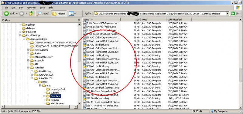

I don't work with metric, but if you select the acadiso.dwt template from your AutoCAD 2011 Templates folder, your drawing will already be set up for metric. If you pick one of the ISO templates farther down the list in that same folder, you be set up for metric, plus you'll have a sample TitleBlock to work with.
