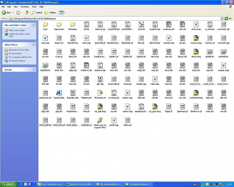

skfarkowsky Posted September 25, 2008 Posted September 25, 2008 Hi All Just started using Civil 3D at work and I got a problem straihgt away:( When I open it I don’t get the main TOOLSPACE. I go to GENERAL-ê TOOLSPACE and get the message “There are currently no palettes to show in the Toolspace window”. I looked for help on AUTODESK website and found only solution for CIVIL 2006 ( I cannot insert the link as a new user). The file mentioned there CIVIL.CUI is not in Program Files (probably because it’s the solution for an older version J ) . Does anybody know what to do to fix it? Thanx for any help Regards, Peter Quote
ReMark Posted September 25, 2008 Posted September 25, 2008 Did you bother to check for the presence of any CUI's in your program files? Did you encounter any problems when the program was initially installed or didn't you do the installation? Quote
skfarkowsky Posted September 25, 2008 Author Posted September 25, 2008 CIVIL.CUI file I've found was in C:\Documents and Settings\sloninap\Application Data\Autodesk\C3D 2008\enu\Support The instruction for C3D 2006 was to copy CIVIL.CUI file from Program Files and put into Document and Settings folder. I checked my colegues' PC with C3D which is working fine and there is no CIVIL.CUI file in Program Files. Is it in other directory in 2008? Thanx Quote
ReMark Posted September 25, 2008 Posted September 25, 2008 Was there a name change? What CUI's appear on your collegue's PC? Quote
skfarkowsky Posted September 25, 2008 Author Posted September 25, 2008 The problem is that the CIVIL.CUI is not in the Program Files on my collegue's PC and it's working fine. I attached the screenshot of that folder Thank you Quote

BOB'27T Posted September 25, 2008 Posted September 25, 2008 On the command line type "show TS". That should bring it up. Quote
skfarkowsky Posted September 25, 2008 Author Posted September 25, 2008 I've tried that adg got the message: There are currently no palettes to show in the Toolspace window Quote
rustysilo Posted September 25, 2008 Posted September 25, 2008 I would be inclined to do a repair install. Quote

Rsblades Posted August 26, 2009 Posted August 26, 2009 On the command line type "show TS". That should bring it up. I would be inclined to do a repair install. Bob, the problem isnt that it wont come up, the problem is that when it does Try to come up there is an error stating there are no pallets. I had this same problem with my first install of 2010 C3D. I agree with doing the repair install however, if that does not work i suggest doing a complete "clean" uninstall then reinstall it. make sure you look up the instructions on how to do a clean uninstall with your version of cad, if you dont follow the directions in which folders to delete after the uninstall then the reinstall could have the same issues as before, maybe more. Quote
longcrier Posted August 31, 2009 Posted August 31, 2009 I got this problem after installing an update. I ended up hunting down my old civil.cui file (the "read me" tells you to save your cui files before running the update, but I didn't) reloaded it and toolspace came back. This makes me hesitant to install updates. Quote

Krztoff Posted September 11, 2009 Posted September 11, 2009 This happened to me once, and one workmate as well, we both modified our .CUI files, I simply changed some keyboard shortcutsl and after that it all went terribly wrong, no, the new shortcuts worked like a charm, but civil didn't have any palettes, the same for my workmate, ended up doing a repair from the cd. Tried a lot of things but nothing else worked. I believe that there is an issue with civil 3d, because autocad users modify .cui quite often without any trouble. My advice is to do a re-install, if that doesn't work then do a clean install. Quote
ReMark Posted September 11, 2009 Posted September 11, 2009 CadKid: Before you do a re-install I'd try a Repair. Quote
Krztoff Posted September 11, 2009 Posted September 11, 2009 Yup, a REPAIR first!!! I mixed up the terms, after repair fails (but I think it shouldn't, as it worked for me just fine) then after that you can do a re-install. Quote
