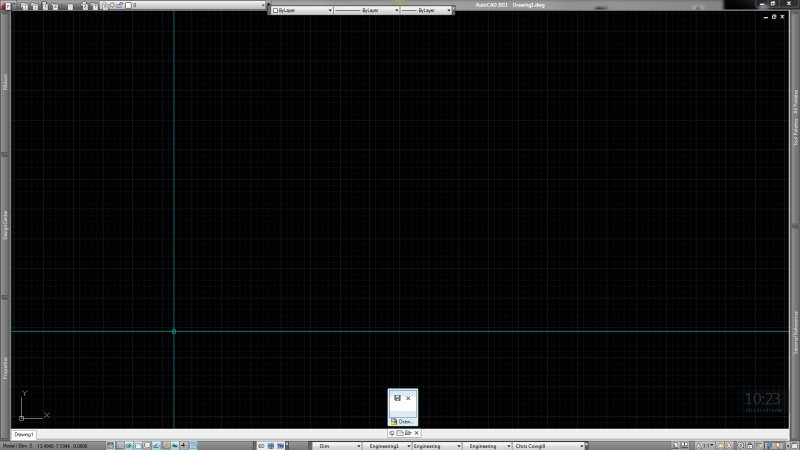

ccowgill Posted February 1, 2011 Posted February 1, 2011 By default, coordinates are absolute, right??? There should be no need to use the # sign unless dynamic input is on, but thats only in 2011 I t hink... 2009, 2010, and 2011 Ugh' date=' I just could NOT get used to it. Dynamic Input went the way of the ribbon for me!! [/quote'] try working with this screen layout Quote
JPlanera Posted February 2, 2011 Posted February 2, 2011 Funny, cause that's what my screen looks like! All clean except for the layers toolbar! I am a keyboard junkie... Quote

Glen1980 Posted February 2, 2011 Posted February 2, 2011 I find the only way to get to absolute 0,0 is to enter it directly into the command line to circumvent the dynamic input, but I'm going to try the '#'. try working with this screen layout [ATTACH]26003[/ATTACH] That used to be my screen with a load of the more esoteric commands on the right click menu, but for some reason I now have a few drop down menus at the top and the quick toolbar along the top. Funny, cause that's what my screen looks like! All clean except for the layers toolbar! I am a keyboard junkie... Got to love the keyboard, O, L , PL, TR etc. so much quicker until you get to LAYERUNISO Quote
