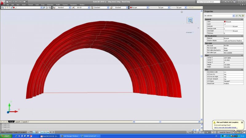

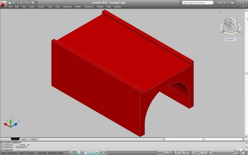

Does anyone know how to create a curved roof (barrel vault construction). It is basically a semi - circle shape which then meets a flat roof.
Is it possible using the roof slab tool?
I am using AutoCAD architecture.
Thanks in advance.
Hi,
i do not know if I understand it,
mean a shape similar to this?
To put it simply draw its cross section and extrude it.
That 's what you were looking for?

I am trying to model a roof like this, which is semi-circular shaped. I didnt know you could extrude, so I will investigate this.
Like ReMark said, sounds like you could just draw the cross section of the roof and then extrude it.
marmo actually suggested drawing the cross-section and extruding it. I was just flapping my gums! LOL

Sorry for the slow response.
I managed to extrude the curves but was a bit disappointed as I could not add windows etc to the curved roof which I could have done if it had known the curve was to have the properties of a roof.
Thanks for your help.
There has to be a workaround. I'm sure there are plenty of curved roofs that have openings of some sort in them.
