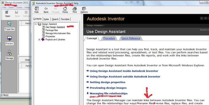

Start Design Assistant and open the top level file that references all relevant files (probably idw of iam).
Use Design Assistant (see attached) to rename files and the relationships are maintained with links to the new names.
Takes a bit of work to figure it out the first time through - so use a sample dataset to experiment till you get it figured out.
