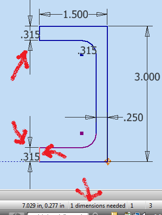

JD Mather Posted November 28, 2011 Posted November 28, 2011 Sketch1 indicates you need 1 dimension (or in this case - a vertical constraint on the line shown red here). Also, you could simplify and remove one dimension by making those two lines equal = constraint rather than dimension both. You should not be using Alias Edit on this part. Quote

Zoner Posted November 28, 2011 Posted November 28, 2011 Thanks for your fast reply I understand that the sketch for the Left U Channel is not perfect, but the problem is applying the second face draft ... on the extrusion obtained from it. I got the sketch ok (yes it could be defined more logically), I got the extrusion ok, I also got one of the face draft on the extrusion working but ... when I try to add the second face draft at the other end, it cuts the long part, not the end of the part ... removing the first face draft at the same time ... that is why I used the Alias Edit on the part ... That is my problem I have to admit that I don't see how applying better constraints to the sketch could allow the second face draft to be applied ... Quote
JD Mather Posted November 28, 2011 Posted November 28, 2011 I have to admit that I don't see how applying better constraints to the sketch could allow the second face draft to be applied ... You must learn to walk (crawl?) before running. I refuse to help anyone who can't do something as basic as constraining a sketch. You might want to read this document - http://home.pct.edu/~jmather/skillsusa%20university.pdf BTW - the Frame Generator in Inventor will create these cuts for you. Quote
Zoner Posted November 28, 2011 Posted November 28, 2011 You must learn to walk (crawl?) before running.I refuse to help anyone who can't do something as basic as constraining a sketch. Thanks anyway ... I do have a tough time understanding how constraining might help applying a second face draft ... I will try extrusion like I did in the Center U Channel and I will redo the Left U Channel with more logical constraints You might want to read this document -http://home.pct.edu/~jmather/skillsusa%20university.pdf Reading it now ... BTW - the Frame Generator in Inventor will create these cuts for you. Thinking of adding my part to it's library, so I will have to learn more ... Again, thanks for your time. Quote
Zoner Posted November 28, 2011 Posted November 28, 2011 You were right ! A fully constrained sketch allows applying two face drafts ! Wow ! I would never have thought ! Thank you very much ! The part file is even smaller ! Cool ! Here is the fully constrained part ! You are right, I am a newbie ... about 8 hours of Inventor under my belt ! This means that the tool is great ! By the way, I have a Bachelor in Physics and a Master's Degree in Human Factor (Ergonomie des interfaces), sorry about wanting to run before learning to walk ... I do have that reflex lol My next step is to intergrate those parts into the Frame Builder library ... for that, I bought "Mastering Autodesk Inventor 2012" I am learning a GREAT TOOL ! This is fun ! Again, Thanks ! Left-U-Channel-0.25-Version2.ipt Quote
