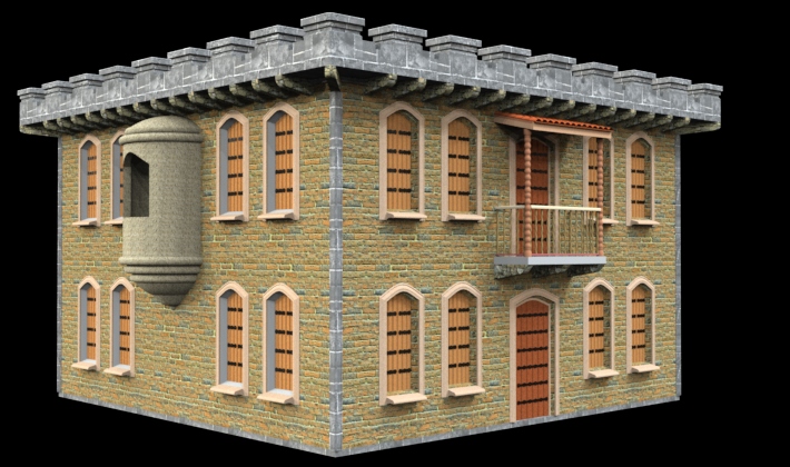

I have a drawing (DWG of 91.4 MB. I have autocad 2010 so when I open the drawing is too slow,I cant work...if I turn off some layers still doing the same thing...too slow....

I include an image of what I doing..a casttle...30'-0" x 30'-0" x 18'-10"...
Was the drawing originated in Autocad or some other program?
Have you tried using "purge"?
Divide the drawing up into three and Xref two of the drawings into the third.
You can have a drawing for the parapet wall, one for all the windows/doors and the third can be the walls.
