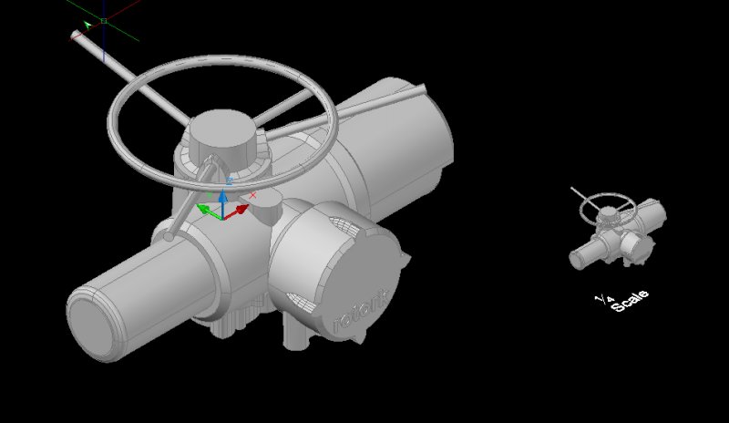

This is where AutoCAD can really come in Handy...
[ATTACH]26186[/ATTACH]
Thank you Ken. Why? I never thought of that...
I have been looking at how to do this in inventor for agess... how did you do it in auto cad ken?

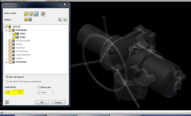

Derive Component
Well, there you go Robert. Thanks JD, did not know that...
...in AutoCAD use the Scale command.
other than use the Derive Component to scale in Inventor I think there is also routine in the SDK to uniformly/non-uniformly scale within a part file without going the Derived route.
Thank you JD for the info/feedback...
