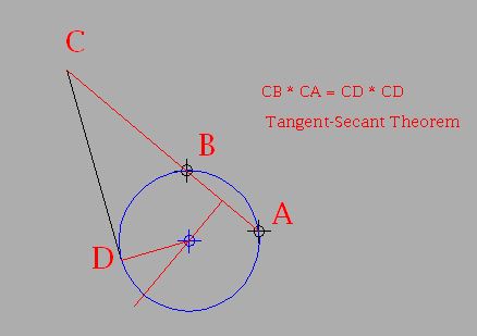

After a bit of delving, I think that the Tangent-Secant Theorem is the geometrical solution.
Given two points A and B and a tangent line, then proceed thusly:-
produce the line AB to meet the tangent line at C. Then the length CD is given by the equation
CB x CA = CD²
A calculator is needed (probably), but there are graphical solutions.

I am afraid that JD Mather mis-read the latest request that was for a Geometrical solution, and his solution must be said to be incorrect.
AB x AC = CD²

I was expecting that you could create a graphical solution for the term CA x CB = CD², and that is why I put the (probably) at the end.
You have a rectangle with sides CA and CB. All you have to do is to find the square of equal area which will give you CD.
Over to you now.
Edited by eldon
corrected expression - oops
In fact, I have just spotted my deliberate mistake. :oops:
In the posted picture, the equation should be CA x CB = CD²
