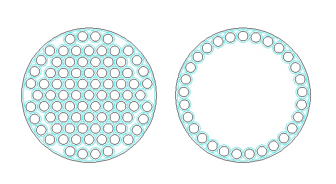

Using Autocad 2000LT and trying to locate as many 1.5" diameter circles as I can within a 21" diameter circle keeping all the circle .500" apart from any other circle and .500" away from the outer edge. Am using the aray function. Trying to bring the first circle up to the line thats .500" in from the 21" outside diameter. First when I zoom the 1.5" circle looks like a series of lines, not a smooth round circle. First how do I smooth out the appearance of the circle. Second, what comands do I use to move the edge of the circle to just tough the line so that when I measure from the outside dia to the far edge of the small circle I get 2". Thanks

If you offset the 21" circle inwards 1.25, and then draw your 1.5 dia circle centered on that line, it will be perfectly placed.

I can get 85 small circles inside. Any advances?
I'm unclear whether the goal is to fit as many small circles as possible inside the large circles, or to fit the maximum number of circles inside the perimeter? My method was slightly different than eldon's as I increased the small circles by 1/4" and reduced the large circle by 1/4" to maintain the 1/2" spacing.
To directly answer the original question, I would draw a line starting a the center of the small circle and ending perpendicular to the large circle (or other line). Then move the small circle using the intersections of the new line as snap points.
