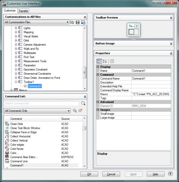

SanMiguel Posted February 15, 2011 Posted February 15, 2011 Hi, newbie in the forum, like the title says, i wanted to make a Pull Down Menu where i can insert my Dynamic Blocks, I already made a "Tool Palette" for my blocks but I wanted to insert them in the Pull Down menu as well. i tried one time but every time I make a new drawing the block I inserted just insert a plain block and not as a dynamic block. Anyway I can go around this problem? Also i wanted to make a custom toolbar with a PLine command but with the custom layer and specific linetype for it. Appreciate your replies in advance guys. if any questions have been raised before links would be appreciated as well. Tried the search function but no luck. cheers.... Quote

Sittingbull Posted February 22, 2011 Posted February 22, 2011 Do you get your dynamic block after exploding the one you insert with your toolbar? If so, you just need to add the explode command in your shortcut. Quote
SanMiguel Posted February 22, 2011 Author Posted February 22, 2011 Firstly, if you have gone to trouble of creating a fairy complex dynamic block within a drawing as a definition, you can save it in block editor by choosing 'save block as', ticking the box that says 'save block definition as file' , choose he original name of the block from the list, or create a new name, navigate to the location of the originally saved block and overwrite it. im sorry its either im using an older autocad 2006 or i just dont really get how to get this. i can save the file as a dynamic block as a different name but not as a wblock with the dynamic block properties to goes with it. Secondly, you can just navigate to the location of the original wblock you created, open that drawing, enter block editor, create your dynamic attributes, and save the entire drawing. This also achieves the same result apologies again but isnt wblock a file??? therefore i cannot open it in Block Editor, unless ofcourse im missing something??? Do you get your dynamic block after exploding the one you insert with your toolbar sorry but i really dont understand what you want to ask me. My problem is Dynamic Block in Pull Down Menu....or Dynamic Blocks as Wblock so i can fairly make a pull down menu for my Dynamic Blocks. Anyway Thanks for the help guys.... Quote
Sittingbull Posted February 22, 2011 Posted February 22, 2011 apologies again but isnt wblock a file??? therefore i cannot open it in Block Editor, unless ofcourse im missing something??? Right!!! But not with dynamic blocks. You cannot have a dynamic block on the first lvl of your dwg file. Dynamic blocks need to be "blocks" in that dwg file, in order to be able to edit them. That's why you have to explode them when inserting them into other drawings. Otherwise, you have a "dynamic block" in a "block". Did you tried to explode your block after inserting it in a drawing? Quote
SanMiguel Posted February 22, 2011 Author Posted February 22, 2011 Right!!! But not with dynamic blocks.You cannot have a dynamic block on the first lvl of your dwg file. Dynamic blocks need to be "blocks" in that dwg file, in order to be able to edit them. That's why you have to explode them when inserting them into other drawings. Otherwise, you have a "dynamic block" in a "block". Did you tried to explode your block after inserting it in a drawing? OK after figuring out what you told me and tried putting explode...finally it works....now the problem am facing is i need to make a script for it.....any ideas??? you are one clever dude!!! (Tears of joy!!!) Dank u wel!!! Merci!!! Danke!!! thank you so much!!! Quote

SanMiguel Posted February 22, 2011 Author Posted February 22, 2011 I thought you said exploding didn't work. As it does try prefixing the block name with a * INSERT *myBlockName sorry about that, i knew i was doing something wrong about the process... anyway i tried to put * before the Blockname.,it work but when i tried to insert the same block on the same dwg its no longer dynamic. this is the script i got so far... -insert *Catch_Basin i wanted to insert a dynamic file from the pull down menu then pick a point in the model space and set rotation to 0 and scale factor to 1 thanks again guys.... Quote
Sittingbull Posted February 22, 2011 Posted February 22, 2011 ^C^C-insert *yourblock.DWG Does this help? SB Quote
