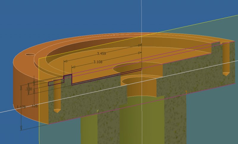

Here's my problem: I modeled two different parts to make a rough out assembly, basically a tube and plate welded assembly. Now I want to do some finish machining on the assembly. I started a sketch in the assembly, placed my constrained geometry on a Workplane and attempted to do revolve cut, but all I get is the warning dialog that says “ No visible, unadaptive sketches “. O.k., so any input on what I might be doing wrong?

Oh, and I better mention that I don't want the machined sketch geometry on the assembly to reflect back to the part (.ipt) of the plate,,,, if this makes since
Your sketch must be at the assembly level to do an assembly level cut.
Can you attach the assembly here.

P.S. yes,,, it is at the Assembly Level, if this helps

Well,,, here's something odd,,, it worked fine this morning. Did the same sketch at Assembly Level as I did yesterday and now it works, which is good. Maybe I missed something yesterday.
