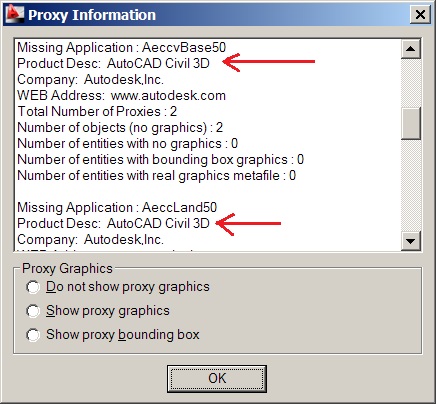

I can't help with the automatic downloading, but installing the Object Enabler isn't as daunting as it may seem.
There may be a lot of individual "applications" listed, but they're probably all contained within a single Object Enabler download. Don't worry about the "Application name" just download the Object Enabler that matches the "Product Description"
Here's an example from my 2011, but your 2008 should look very similar.
