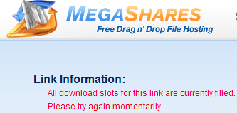

G_TAK Posted February 17, 2011 Author Posted February 17, 2011 Thanks, http://d01.megashares.com/dl/db6ef6f/mech-modules.ZIP Actually that is easier here is the file for download... Quote
BlackBox Posted February 17, 2011 Posted February 17, 2011 Thanks, http://d01.megashares.com/dl/db6ef6f/mech-modules.ZIP Actually that is easier here is the file for download... Bad link.... Quote
G_TAK Posted February 17, 2011 Author Posted February 17, 2011 OK...sorry Mega shares is 1 link @ a time....someone must be downloading Quote
