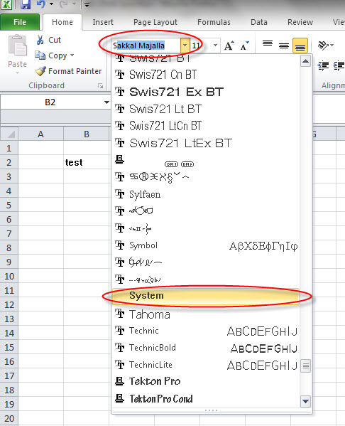

Set all text in excel to system.
That is the best suggestion I have read in a long time...mostly b/c it's simple and it works!
How to set all text in excel to system? What is the system font?

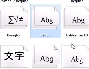

Calibri is a True Type font just get a copy of it and add to your system\fonts, pretty sure 2009 used TTF.

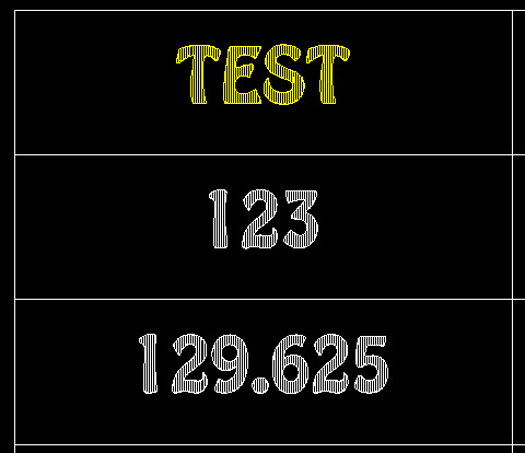

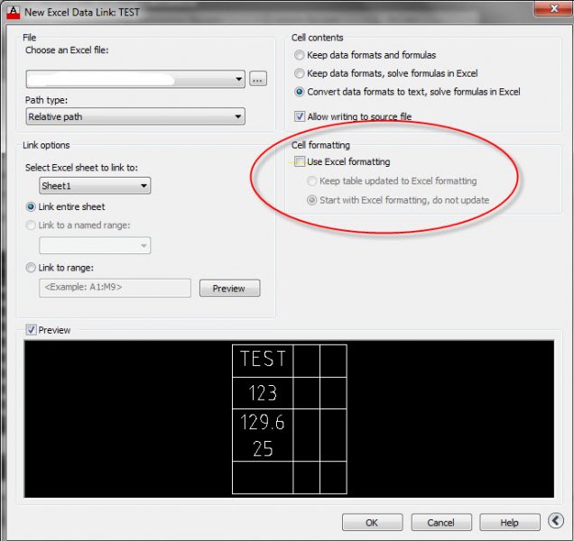

One way of getting these fonts into AutoCad tables easily (with the desired font obviously set up to be used in the table and text style properties) is to uncheck the "Use Excel formatting button" when creating the datalink (obviously you lose any Excel formatting then, so it is a trade off).
[ATTACH=CONFIG]39445[/ATTACH]
[ATTACH=CONFIG]39446[/ATTACH]
[ATTACH=CONFIG]39447[/ATTACH]
:DThanks a lot! There is no "System" font listed in my Excel, but I just input the word "System" in Excel's font combobox, and it's OK! Thank you very much!:thumbsup:

thanks for the "set your text to system" advice, after trying to figure it out for an hour this little advice got it done in seconds

I found an answer on another site that works! Copied directly from the AUGI forum, from user Capt. Computer Crasher:
"With Excel linked Tables in 2008, right click on a cell in the table, pick Data Links>>>>
Edit Data Link "Name of Data LInk". In the data link editor under "Cell Content" uncheck "convert data types to text" and under "Cell Formatting" uncheck "Use Excel Formatting" (these are on the right hand side if you do not see them click on the ">" at the bottom right hand corner next to the help button. this will expand the box). when the values set are right hit ok. then click on the table or highlight all cells, right-click and pick "Remove All Property Overrides". this will allow the table style in AutoCAD to have control.
To edit globally highlight all the CELLS in the Table (NOT the whole table). right click then choose properties or any other command under right click"
