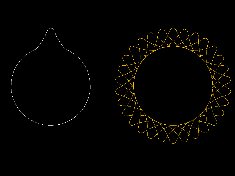

khoshravan Posted February 18, 2011 Posted February 18, 2011 Spirograph, as some of you may know is curves obtained by sliding a circle inside or outside another circle with different radius without slipping. There is a toy for drawing these graphs as well. I read in a site, it is possible to draw them on computer as well (http://wordsmith.org/anu/java/spirograph.html) but I couldn't succeed. I want to know is it possible to write a VBA in AutoCad so that I draw them in AUTOCAD? Any comment is highly appreciated. BR Khoshravan Quote

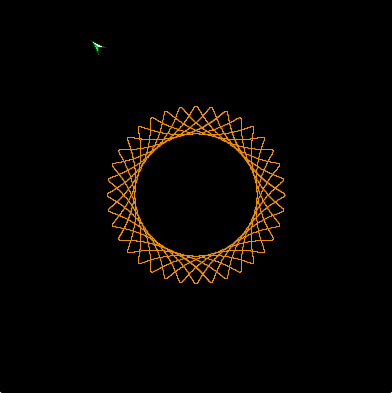

kencaz Posted February 18, 2011 Posted February 18, 2011 You can simulate them quite easily with a polar array. Autocad: From Website: KC Quote
nestly Posted February 19, 2011 Posted February 19, 2011 There's a plugin at Autodesk Labs, that's supposed to work with 2007 and newer http://labs.blogs.com/its_alive_in_the_lab/2010/05/adn-plugin-of-the-month-spiro-for-autocad-now-available.html Download page (May 2010) http://labs.autodesk.com/utilities/adn_plugins/supported_apps/ Quote
Jack_O'neill Posted February 19, 2011 Posted February 19, 2011 Or even just a simple circle arrayed around itself: Quote
fuccaro Posted February 19, 2011 Posted February 19, 2011 For a real one you will need some programs but for decorations use the array command as above. Quote

SEANT Posted February 19, 2011 Posted February 19, 2011 Here’s my attempt. It basic; requiring a very specific setup. See the attached file for the general orientations required by the routing. With certain radius ratios this routine would benefit with a bit of recursion, but this was all the time I could invest in it. Option Explicit Const TwoPi As Double = 3.14159265359 * 2 Sub CreatePattern() Dim StationaryCircle As AcadCircle Dim RotatingCircle As AcadCircle Dim PenPoint As AcadPoint Dim tempPoint As AcadPoint Dim varPkPt As Variant Dim rotationAngle As Double Dim ent As AcadEntity Dim Origin(2) As Double Dim PenPt() As Double Dim SpiroCurve As AcadSpline Dim startTan(0 To 2) As Double Dim endTan(0 To 2) As Double Dim fitPoints(0 To 194) As Double Dim RadRatio As Double Dim vararray As Variant Dim varNewarray As Variant Dim NumOfArray As Integer Dim NumOfInitialRotations As Integer Dim Remain As Double Dim count As Integer Dim SeqBlock As AcadBlock Dim ref As AcadBlockReference On Error Resume Next With ThisDrawing.Utility .GetEntity ent, varPkPt, "Select Circle at WCS origin: " If Err <> 0 Then Exit Sub If TypeOf ent Is AcadCircle Then Set StationaryCircle = ent Else: Exit Sub End If If Round(DistBetween2PtST(Origin, StationaryCircle.center), 6) <> 0 Then Exit Sub .GetEntity ent, varPkPt, "Select Circle that rotates: " If Err <> 0 Then Exit Sub If TypeOf ent Is AcadCircle Then Set RotatingCircle = ent Else: Exit Sub End If If (StationaryCircle.radius + RotatingCircle.radius) - RotatingCircle.center(0) > 0.0000001 Then .Prompt "Circles are not situated correctly! Operation Cancelled. " Exit Sub End If RadRatio = StationaryCircle.radius / RotatingCircle.radius NumOfInitialRotations = Round(RadRatio) Remain = RadRatio - NumOfInitialRotations If Abs(Remain) < 0.0000001 Then NumOfArray = 0 Remain = 0 End If .GetEntity ent, varPkPt, "Select Pen Point in rotating circle: " If Err <> 0 Then Exit Sub On Error GoTo 0 If TypeOf ent Is AcadPoint Then Set PenPoint = ent PenPt = PenPoint.Coordinates Else: Exit Sub End If Dim i As Integer fitPoints(0) = PenPt(0) fitPoints(1) = PenPt(1) fitPoints(2) = PenPt(2) For i = 1 To 64 Set tempPoint = PenPoint.Copy tempPoint.Rotate RotatingCircle.center, (TwoPi / 64) * i tempPoint.Rotate StationaryCircle.center, (TwoPi / 64) * i * (RotatingCircle.radius / StationaryCircle.radius) varPkPt = tempPoint.Coordinates fitPoints(i * 3) = varPkPt(0) fitPoints(i * 3 + 1) = varPkPt(1) fitPoints(i * 3 + 2) = varPkPt(2) tempPoint.Delete Next Set SeqBlock = ThisDrawing.Blocks.Add(Origin, "oneTurn") Set SpiroCurve = SeqBlock.AddSpline(fitPoints, startTan, endTan) rotationAngle = (TwoPi / RadRatio) For i = 0 To NumOfInitialRotations - 1 Set ent = SpiroCurve.Copy ent.Rotate Origin, rotationAngle * i Next Set ref = ThisDrawing.ModelSpace.InsertBlock(Origin, "oneTurn", 1, 1, 1, 0) If Remain <> 0 Then rotationAngle = (rotationAngle * NumOfInitialRotations) - TwoPi NumOfArray = Floor(Abs(TwoPi / rotationAngle), 1) For i = 0 To NumOfArray - 1 Set ent = ref.Copy ent.Rotate Origin, rotationAngle * i Next End If End With End Sub Function DistBetween2PtST(dblPt1 As Variant, dblPt2 As Variant) As Double DistBetween2PtST = Sqr((dblPt2(0) - dblPt1(0)) ^ 2 + (dblPt2(1) - dblPt1(1)) ^ 2 + (dblPt2(2) - dblPt1(2)) ^ 2) End Function Public Function Floor(ByVal X As Double, Optional ByVal Factor As Double = 1) As Double Floor = Int(X / Factor) * Factor End Function SpiroSetup.dwg Quote
