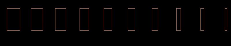

tavorios Posted February 22, 2011 Author Posted February 22, 2011 Attached is a picture of what I mean. The pattern I have is a little bit more complex than the picture and I need 128(minimum) elements. Each element is scaled only in on the x axis. I'm fairly new to autocad so I was hoping for a solution that did not involve AutoLISP. That said, if there is no other way, what is the learning curve for AutoLISP. Thanks for the time. Quote
rkent Posted February 22, 2011 Posted February 22, 2011 Attached is a picture of what I mean. The pattern I have is a little bit more complex than the picture and I need 128(minimum) elements. Each element is scaled only in on the x axis. I'm fairly new to autocad so I was hoping for a solution that did not involve AutoLISP. That said, if there is no other way, what is the learning curve for AutoLISP. Thanks for the time. [ATTACH]26315[/ATTACH] I can approximate that but with the rectangles getting closer together. I drew a rectangle, made it a region, changed the ucs, did a circular array, went back to WCS, used the flatten command. Quote
tavorios Posted February 22, 2011 Author Posted February 22, 2011 rkent, My design requires the pitch to be the same along the array. Thanks though. Quote

paulmcz Posted February 23, 2011 Posted February 23, 2011 (edited) Here is a simple lisp program that draws a rectangle 13 x 5 and arrays it 128 times, with unit distance 15 to the right. Each rectangle to the right is narrower by 0.1. (defun c:as (/ ra rb rc rd di n ip dis osn) (command "_.undo" "begin") (setq osn (getvar "osmode") ra 13.0;(getdist "\n Rectangle horizontal dimension: ") rb 5.0;(getdist "\n Rectangle vertical dimension: ") di 15.0;(getdist "\n Constant unit distance: ") n 128;(getint "\n Number of units in array: ") ip (getpoint "\n Insert first rectangle by lower left corner: ") rc (polar ip 0 ra) rd (polar rc (* pi 0.5) rb) dis (+ di di) ) (setvar "osmode" 0) (command "rectang" ip rd) (while (<= dis (* di n)) (setq dis (+ dis di) ip (polar ip 0 (+ di 0.1)) rd (polar rd 0 di) ) (command "rectang" ip rd) ) (setvar "osmode" osn) (command "_.undo" "end") (princ) ) Edited February 23, 2011 by paulmcz left - right mix-up Quote
