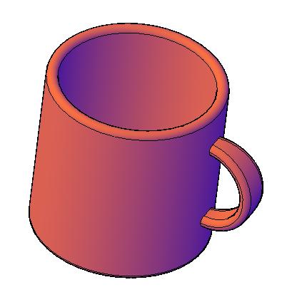

SLW210 Posted February 23, 2011 Posted February 23, 2011 mug based on your script:[ATTACH]26344[/ATTACH] Where's the coffee? Quote

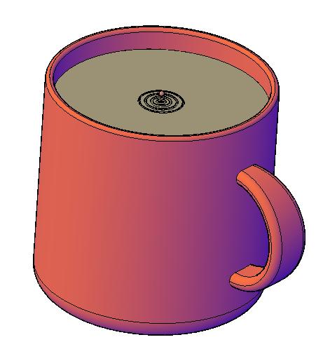

Jack_O'neill Posted February 23, 2011 Posted February 23, 2011 Where's the coffee? was making a fresh pot. here ya go Quote

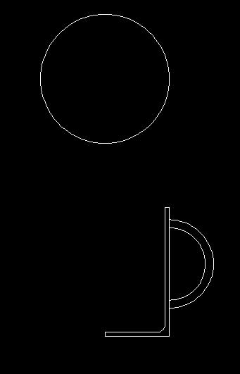

Jack_O'neill Posted February 23, 2011 Posted February 23, 2011 I drew what you saw using the "revolve" and "union" commands. I started out with what your script does and modified the shape as you see below. Draw what basically looks like an L, whatever thickness you want the cup to be. pedit it into a closed polyline, (or draw it that way to start with!). Revolve it around the center of the cup 360°. Then offset the arc that makes the handle, close the two open ends to make it a closed poly line and revolve it around the same center point 15°. Union the handle to the cup, fillet the sharp edges and you're done. Quote

Jack_O'neill Posted February 23, 2011 Posted February 23, 2011 Try drawing the L shape first then use a "revolve all" to select. Then have it draw the shape for the handle, and do another revolve all. It will reject the solid you already did. Then do the union the same way. Just make sure there are no other objects in the drawing, because it will revolve "all" that is revolvable (is that a word?). Quote

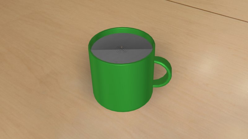

Jack_O'neill Posted February 24, 2011 Posted February 24, 2011 got to playing around with rendering the mug Quote
