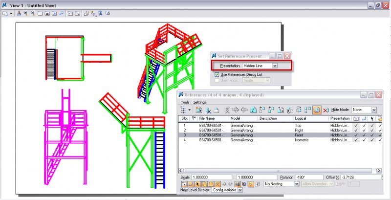

On a side note in XM and V8i you can now attach 3d files to 2d files. The attachments can use the standards views Top, Front, Right etc and the the Presentation mode can be set to Hidden Line. Much more efficient when edits occur to the master model. see screen capture
