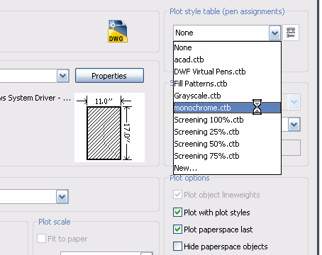

Change plot style table from none to monochrome in one hit
As per header. Is there anything (command, variable) I can change it without opening dialog box.
Need to revise and print new set of dwgs and all of them are setup to none.
Please and thank you.
I did it( see picture) but I need something faster in command line or macro...
