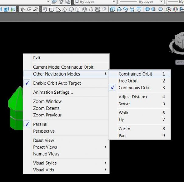

When you select the orbit command, you get the icon for orbit under your curser. Right click will open a new menu, select constrained orbit(1). You can always use the help file also.
Yes, but I'm trying to get it to orbit continuously and be constrained by the z axis. Used to be able to do both with V2000. Can't seem to do it with V2010
I have been trying also. I cannot make orbit continuous and constrained at the same time. Sorry I thought I was on to something. I have to dig a little deeper to find the answer.

Sadly, they have ripped that option in the newer versions... :(
