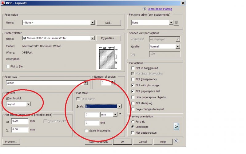

nestly Posted March 19, 2011 Posted March 19, 2011 If you're printing a scaled layout, then make sure your Plot scale set to 1:1 Quote
B>dobson Posted March 19, 2011 Author Posted March 19, 2011 Sorry nestly, I just realised when i change the viewpoints scale it becomes really small too, i know how to print, i have done what you are explaining before, its just that that was on 2008 and I drew in feet/ inches not meters, dont really know why its not working do you think i need to write 21 meters as 21000.0 as a measurement in autocad at the moment i am writing the it as 21.000? Quote

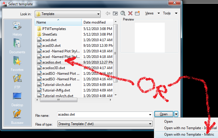

JD Mather Posted March 19, 2011 Posted March 19, 2011 i also have a circle on the design that has a diameter of 50 meters ... Attach file here with this circle (only this circle) in the file. What template did you start from? Quote
JD Mather Posted March 19, 2011 Posted March 19, 2011 I have drawn i line that is 21.000 decimals long ... Decimals is not a unit of length. It is a format of entering magnitude. Quote
B>dobson Posted March 19, 2011 Author Posted March 19, 2011 So how would i design a building i Autocad so that it is in scale is correct... in feet/ inches? Quote
JD Mather Posted March 19, 2011 Posted March 19, 2011 So how would i design a building i Autocad so that it is in scale is correct... in feet/ inches? This is the first time you've mentioned a design intent of feet/inches. Do you want feet/inches (imperial) or mm or Meters (Metric) units? More information is needed. Simply select the correct template and distance entry format in UNITS. This is usually covered in a beginning class. Whatever units you use - the scale is correct when you draw 1:1, then show viewport/plot at whatever scale desired. Quote
