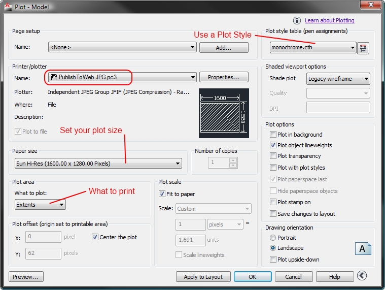

f700es Posted March 24, 2011 Posted March 24, 2011 OK you simply Print your model to JPG. Here is a screen print of the Plot Window... Quote
