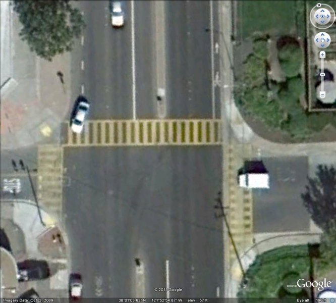

zodiacs Posted March 25, 2011 Author Posted March 25, 2011 Navy and Harbor.dwg SLW210 - Tried it, it just changed the color name to "white" anyway. RS - uploaded, basically, I want there to be a white "fill" color on Harbor. uploaded both items. Navy and Harbor.dwg Quote
resullins Posted March 25, 2011 Posted March 25, 2011 You have to send me the JPG too, it's a reference. Quote

zodiacs Posted March 25, 2011 Author Posted March 25, 2011 Yeah that's basically what I want to do. I'm typing a street name on a picture of a drawing form the aerial view (in this case, Harbor street). I want to be able to read the text easily, so instead of having the city landscape as the background, I want it to be white. Quote
resullins Posted March 25, 2011 Posted March 25, 2011 Use the command WIPEOUT. It will literally let you draw a field that will OMIT anything behind it. Meaning it will wipeout a portion of the JPG, and then you can just use MTEXT like normal in that space. Easy peezy lemon breazy. Quote
zodiacs Posted March 25, 2011 Author Posted March 25, 2011 Resullins - That would work, but sometimes I need to move the street names around. Wouldn't that command remove part of the jpeg permanently? I guess it would be best just to invert my colors and see it as a black fill and white text on model and then have it show up the opposite on print out? I guess the end result is the most important anyway. Quote
resullins Posted March 25, 2011 Posted March 25, 2011 No. It is NOT permanent. As long as you have the WIPEOUT Frames turned on, you can select and move it just like any object. I usually create a NoPlot layer for the frames, and then just leave them on. Seriously, just try it out. Quote
