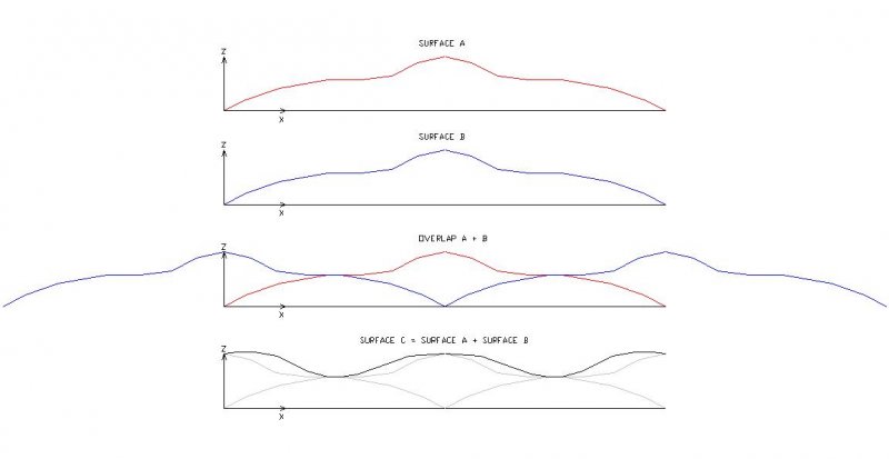

viriato79 Posted March 27, 2011 Posted March 27, 2011 Hi I would like to know if this is possible: I have two surfaces, A and B. I want to create a surface C, with the same x,y reference, but with a z = z(A)+z(B) The result will be a surface with the sum of elevatios of A and B. Thanks Quote

viriato79 Posted March 28, 2011 Author Posted March 28, 2011 No, I use 3d Surfaces to simulate irrigation water depht. Each surface will be a 3d model of a sprinkler water distribuition in flat ground. I would like to overlap sprinklers and sum water depths = sum surface heights. Thanks Quote

viriato79 Posted April 1, 2011 Author Posted April 1, 2011 this is what I would like to do, not in 2d but in a 3d. Quote
LukeT Posted April 1, 2011 Posted April 1, 2011 First up, the diagrams aren't reading like its an addition of z values. As they are 2d graphs of X vs Z, row 1 overlapped on row 2 = same shape, not what is shown in row 3. Then looking at row 3 -> 4, that also doesnt match up. But lets ignore that for now. I dont have CAD available in front of me so cant think of anything more elegant right now, but I will elaborate on my previous suggestion: 1) Start with Surface A and Surface B 2) Make a new surface C at zero elevation. just a flat plane. (extract border from A or B or just draw polyline around A or B, set elevation to 0, add to new surface as only contour) 3) Make a new volume surface D = Surface C - Surface B 4) Make another volume surface E = Surface A - Surface D. Since: D = -B, E = A-D = A -(-B) hence E = A + B Once I get Cad back in front of me i could work out way to invert Surface B in the surface settings w/o having to use Surface C (the flat plane) or Surface D, but that should be a quick workaround to resolve your original request and it will work in 3d Quote
viriato79 Posted April 1, 2011 Author Posted April 1, 2011 First up, the diagrams aren't reading like its an addition of z values. As they are 2d graphs of X vs Z, row 1 overlapped on row 2 = same shape, not what is shown in row 3.Then looking at row 3 -> 4, that also doesnt match up. But lets ignore that for now. You are right, the hights of surface c are higher. thanks Quote
Organic Posted April 1, 2011 Posted April 1, 2011 Hmm, that diagram has made me more confused as to what you are after. Quote
