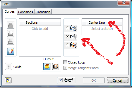

Actually - you don't have a rail - see attached.
